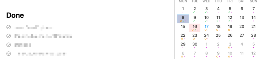

days marked red without unfinished tasks
Some days are marked red. I thought they contain overdue tasks, but on this day all tasks are marked done. Is this a bug? I find it confusing because "red" seems to indicate that something is wrong

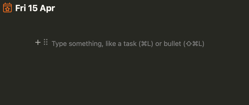

Eduard Metzger: I still have this issue (macOS) and the note for the day is completely empty. I tried closing the app but that didn't do anything.

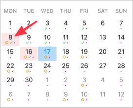

I have this same problem. It's inconsistent enough that I had not filed on it because I couldn't figure out how to MAKE it happen, but it happens and irritates my personal sense of elegance.

By any chance, do you have a code block with a * in it on those days? I experienced the same thing where I had checked everything off on the day but it remained red, indicating a task was overdue. I finally figured out that the issue was that within a codeblock from that day, I had an asterisk which was triggering NotePlan to think I had an incomplete task!
Nov 18, 2021
Stacey: no. I even deleted the content for this day and the day stayed red
