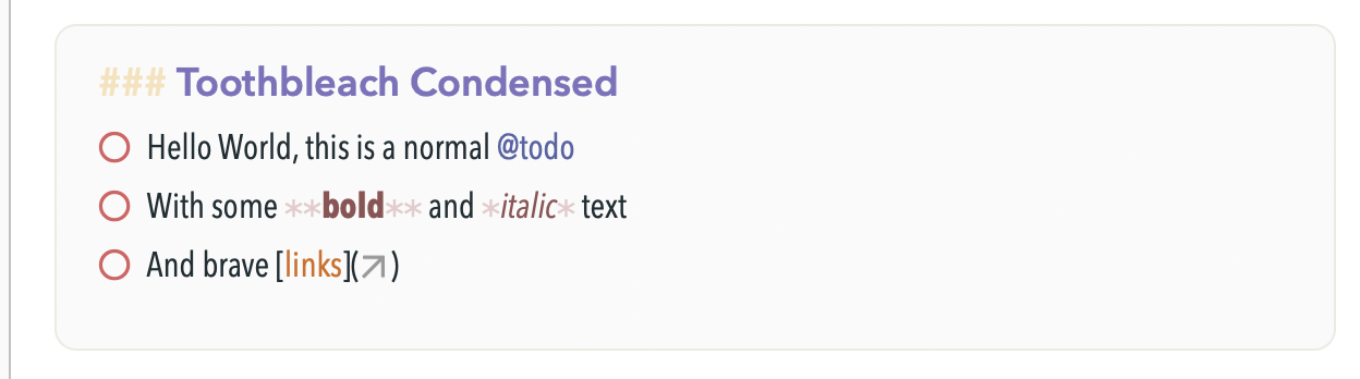

Like this? Test running it, releasing as beta soon.

By the way, the new theme "Toothbleach Condensed" does hide them
