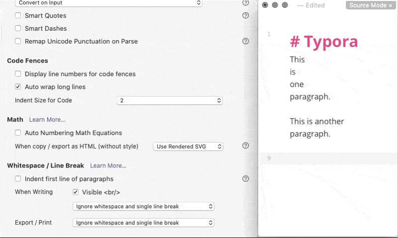

Strict Markdown line breaks option (2 line-breaks = 1 paragraph)
Typora is doing live rendering and supports this feature. 2 line-breaks are rendered as one and one line-break is completely ignored. Obsidian, on the other hand, only respects this when you turn it on in the preferences and only in the preview mode. A possible solution might be to add a context menu entry "copy with strict line breaks", which doubles each line break before saving it into your clipboard.

Copying to the clipboard isn't the issue, or at least is only one aspect of it. In Markdown, a single line is a "soft line break" (e.g. [CommonMark](https://spec.commonmark.org/0.30/#soft-line-breaks)). Some Markdown editors will render newlines as hard breaks and show a newline, but treating a single newline as a paragraph break, i.e. </p><p> in HTML, is always incorrect. This leaves me with an inconsistent toolset: - Typora (correctly) interprets Enter as "new paragraph" and puts two newlines in the raw Markdown, which it renders as a paragraph break. (I can get a single newline with Shift-Enter, or switch to Typora's "raw" mode and use Enter to get a single newline, but I rarely do this.) - NP sees two newlines as an empty paragraph, it produces a single newline when I press Enter, and *it treats a single newline as a paragraph break*. - If I publish to e.g. WordPress or Hugo from the "Markdown" that NP produces, it will render as a wall-of-text in HTML because the parser treats all the single newlines as soft breaks (which is correct). So if I want to use NP as a blog editor for either WP or Hugo (which I'm planning to move to), to get an actual paragraph in NP means I have to hit Enter twice, and NP renders this with too much vertical space because it thinks there is an empty paragraph in between two regular paragraphs, which is also incorrect. So the only solution I can see is to have a "strict" mode (kinda like Typora has) which does exactly that: - Typing Enter is a paragraph break, which is two newlines. - A single newline is a soft break, which renders as a space (or could render as a <br> based on a setting, but is never a new paragraph). - Other conformance with e.g. commonmark. It could even be that relaxed mode applies to one suffix (.md, say) and strict mode to another (.mkd or .markdown). That could get complicated though. So I think it's a bigger and more fundamental deal than what happens when I copy. It is about what NP thinks a Markdown file looks like vs what other tools, and especially publishing/rendering tools that produce PDF or HTML, or publish to blog platforms, think Markdown is (based on a now widely-adopted spec). (By the way, the ignore/preserve whitespace setting that Rhubarb found in Typora is about whether to treat a single newline as a space or as a <br>. It is still never a paragraph break, and a paragraph is still always two newlines.)

Eduard Metzger: I've been thinking about this. Not sure how NSTextView does styling, but you could find newline pairs trivially like `\n\n`, and single newlines with a lookahead regex like this: `(?<!\n)\n(?!\n) ` Then you render a newline pair as a paragraph break (as you are currently doing for single newlines) and render single newlines as either a space or a `<br>` based on user preference/theme. Then making `Enter` produce two newlines, and `Shift-Enter` do one newline (again this can be user preference), then you are pretty much there.
