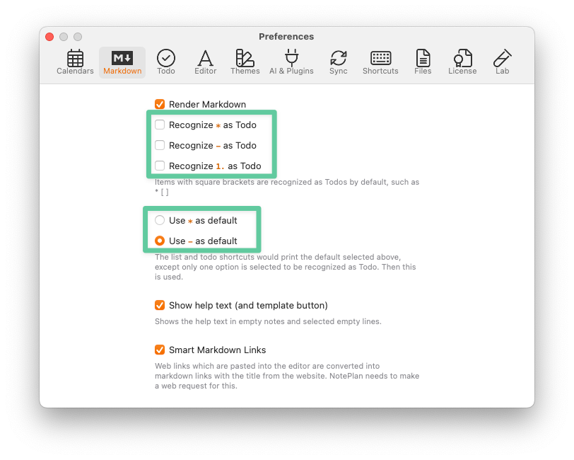

Supported in Markdown settings when you turn off "Recognize * as Todo" and turn on "Use - as default". Will reopen if I misunderstood the request.

Steen Comer Daniel Danilov Did you try this setting? It seems to do exactly what you say (see attached). New tasks (like hitting enter after an existing task) creates as `- [ ]` for me. Do you see something else?

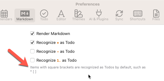

Upon further testing, I do realize that once you select "Recognize `*` as Todo", the creation of new tasks reverts back to using `*` as default. This seems to be a bug. Eduard Metzger. Even if it is, for some unknown reason, intended, the UI doesn't make sense (why would "recognizing `*` as todo" imply "using `*` as default"?

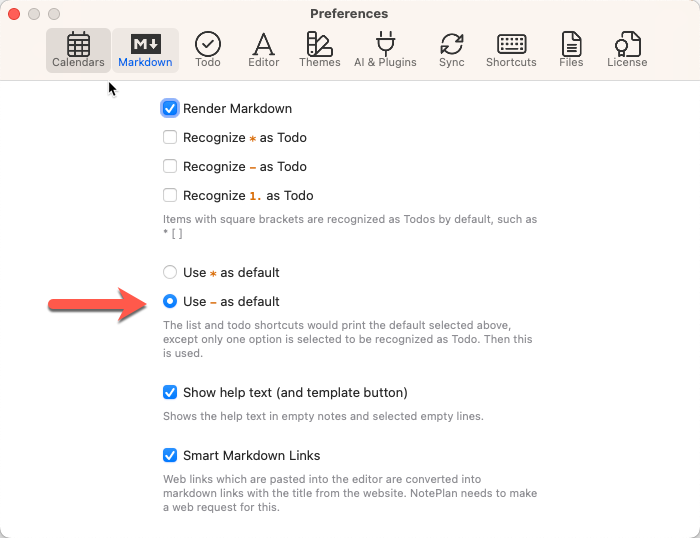

Chris: Seems to work for me as expected. Turn off "Recognize * as todo" and default to "-" and I get `- [ ] ` tasks by default. Turning on "Recognize * as todo" makes the default setting below redundant.

Steen Comer: You need to turn off all "Recognize at" options.

Eduard Metzger: Aha! That worked. In that case, I re-file this as an issue with the text in the settings. I can just barely see the logic of how those settings would lead to this result, but it is, for me, in no way implied.
